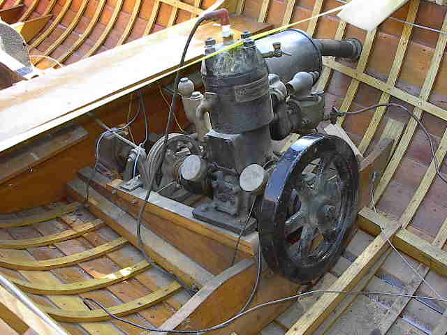

Andrew, Mike Adams here. I need your's and the discussion board's advice on where to go to get the bearings rebabbited on this Thrall engine.The crank journals measure about 1.100, and I need 2 full round bearings and 1 split. I am hoping to find someone in the northeastern U.S. if possible, as I am from the Rochester,N.Y. area. Your help would be greatly appreciated. Thanks, Mike Adams |
