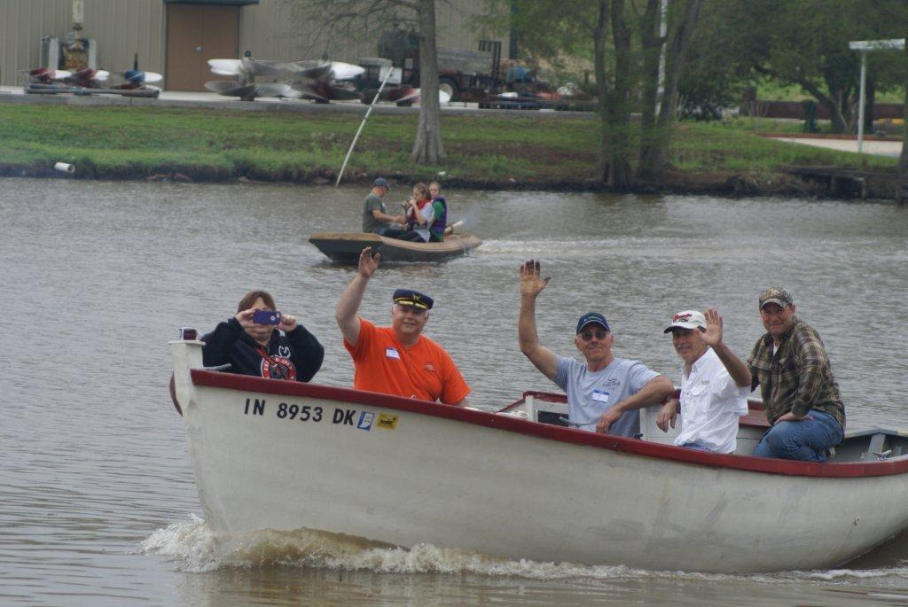

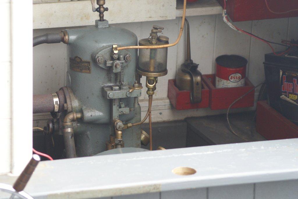

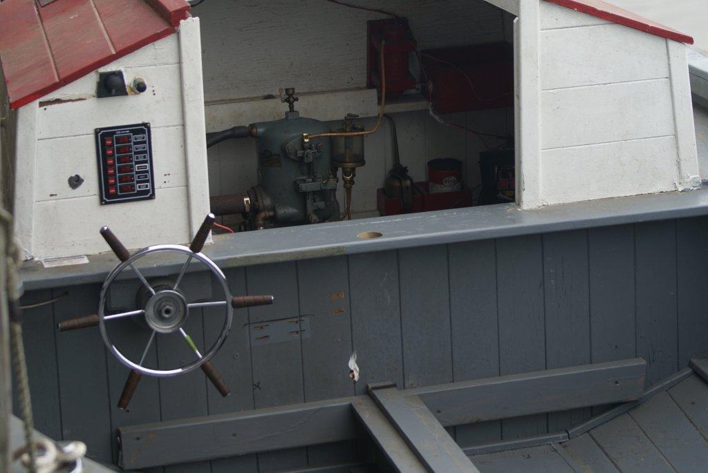

J.B. Castagnos
Senior Member Username: jb_castagnos
Post Number: 890 Registered: 07-2002
| Posted on Sunday, March 30, 2014 - 11:49 am: |
Here's some pictures of Keith Kinney's boat with the 5hp Acadia, he rode people all day long, had a good time.
Tom Hardy
Advanced Member Username: tom
Post Number: 35 Registered: 12-2002
| Posted on Monday, March 31, 2014 - 10:01 pm: |
Nice looking skiff. Seems to be getting along good. |
Dean Chapman
Member Username: unclearpine
Post Number: 6 Registered: 03-2014
| Posted on Wednesday, April 02, 2014 - 04:57 pm: |
I ended up bolting the motor to the floor...It was chasing me around in circles in my garage...I am sure the neighbors had a good laugh..That is a great looking clean rig Keith's got there..The 5 Hp looks a lot like my 4 Hp motor.I got to replace the float because it is flooding the motor after it starts to sink..Tried to fix but shellac and superglue didn't last long..Trying to get one from OTTO http://www.ringspacers.com/index.htm |
miro forest
Senior Member Username: miro
Post Number: 754 Registered: 11-2001
| Posted on Thursday, April 03, 2014 - 09:52 pm: |
The really interesting thing about Keith's boat is most noticeable when he's got the engine running really slow. You can feel the boat speed up and slow down with each stroke of the motor. Not at all unpleasant. I figured that because the hull is so efficient, the initial part of the stroke has the power to accelerate the boat, and then as the piston comes up on the second stoke, the boat decelerates a bit - enough that you can sense it. At high engine speed, the effect is not felt. I can describe it as a gentle chugging motion. The Acadia is running about ( my guess) 200 rpm. All of this PLUS really great friends and terrific Cajun food - especially from the "Wicked Wizard" of the South - deep fried boudin balls-yum! miro |
