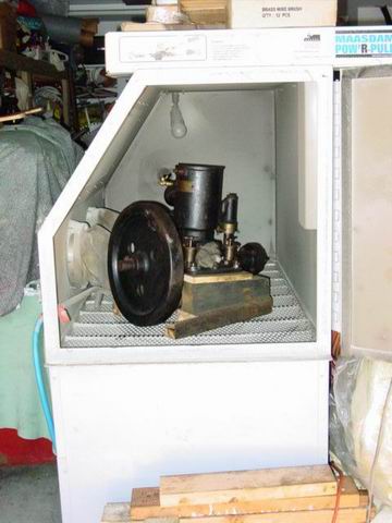

I still use sand blasting to clean large rough castings, wheel rims etc on the tractors I restore. A grain of sand if looked at closely has very sharp edges and actually cuts the surface of the metal and changes the original texture of the metal. For restoring our old engs and many of there parts I find that using a bead blasting cabinet with glass bead material is much better.
A glass bead up close looks like a ping pong ball although they are solid. In the confines of the sealed cabinet the dry stripping is clean ,fast and most important the castings,flywheels etc come out just about as they were when cast originally. I blast crank shafts and then polish the journals. Pistons bead blasted look like new (cast iron). bead cylinder walls and then hone them, come out real nice. Lately I have been using some of the old original rings on many engs, after beading the rings I have installed them as is and have immediate compression and have taken several out and found them to be seating very quickly.
Wouldn't want to continue to restore engs without a bead blaster. this is the one in my shop its a "Scat Blast" not an industrial grade but it works good for what I need. I put a 3 hp
engine in it to give you a size perspective.
